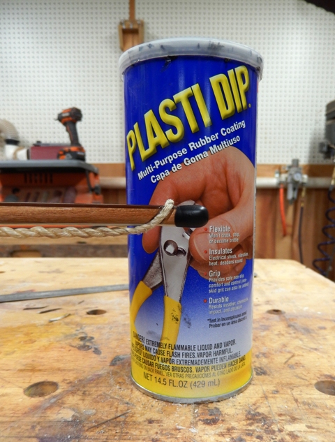

When I went to Cody Wyoming and took John Schulz's class, I had a bow with a limb tip protector on it. After I strung up my bow and presented myself with bow, quiver, and arrows for inspection, John looked at my bow and said "get that thing off there". Which I did. Our conversation took many turns and we never got back to his explanation as to why. Which means that maybe I am still in the dark. That said, for just a little more than the cost of a rubber limb tip protector from 3Rivers, I bought a can of Plasti Dip and can "custom" mold untold thousands of limb tip protectors (and who knows what else?). I often lean my bow against a tree while taking a leak or dressing out a monster buck (usually the former, rarely the latter). So even if it is somehow "bad form" to use a limb tip protector, I guess I will anyway. 2 dips provided a very thin durable tip that won't come off till you want it to. Then it easily peels off, but can't be reused.
Easy Limb Tip Protector content media
