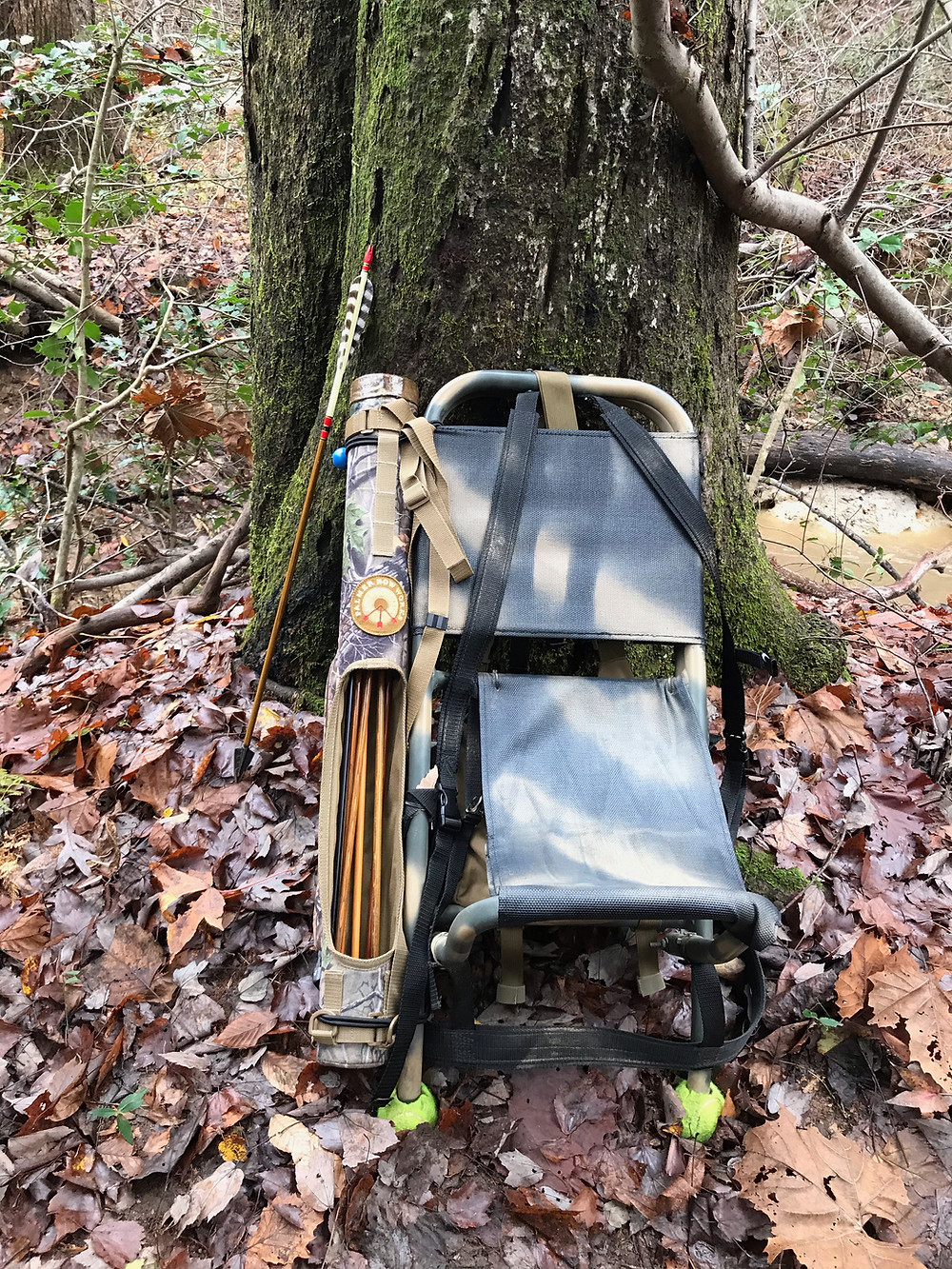

for long sits hard to beat the Dave Waldrop pack seat- only negative for me was couldn't use with my back quiver in a functional mode (had to strap it to the seat) then couldn't get arrows on the move
came up with this -can carry it straped over the same shoulder as the quiver and let it hang to the right side down under the quiver- made from a old Loan Wolf seat and drilled and placed the versa button on the side of seat (a very light Dean Torgus style seat )
works good
for the pack seat had to bunjie ball a tube quiver that I shortened and can load and withdraw arrows from slot or top

Great idea with the tube quiver/Waldron pac seat. I have two of those quivers so will now attach one to my PAC seat.

In its original length the tube quiver was designed for arrow removal with the end covering but extended too high above the pack seat that it hung up on brush
thus I clipped the fabric and cut off the PVC tube to nock height and contacted cemented the outer fabric down inside and then pulled the inside fabric out and over and contact cemented (had to split the inner fabric to get it over
then mixed up 5 min epoxy and covered the rim and fabric to perminatley hold and toughen the top rim
can now get arrows in and out both via the top and side slot
I just leave perminatley bungied to the pack seat now
keep arm guard and tab in the side bouch of the quiver
works great

I went with the tube because I couldn't make my regular Hill style (preferred quiver) work with the pack seat
are you straping the back quiver to the pack seat? or wearing it?
I fiddled and quit
