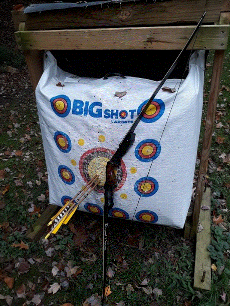

Took my recently acquired Win & Win/Dryad ILF longbow out to the range today to play around with some different arrow combinations. The bow is #48@28 and really likes 45# spine wood arrows with 145gr points. The only problem is that it is very noisy. Or at least it seemed very noisy when I picked it up after shooting a 3D round with my deathly silent Bob Lee Blackhawk. Not having any real experience with ILF bows, are they just a bit noisier than other types of traditional bows? Running a brace height of 7 1/8". Too low? Do I just need to add some string silencers? Or is there something funky going on with the tiller? It groups well with 500 and 600 carbons also so I don't want to screw it up, just make it quieter.
